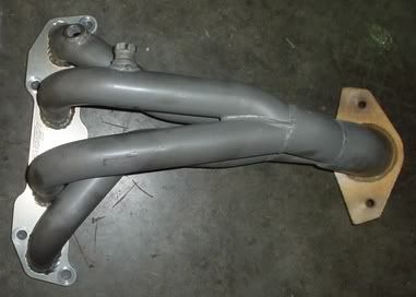

2. Or you can install a catless aftermarket header. If you get a "shorty" (tri-y or 4-1) like Hotshot or Nismo, you essentially replace the stock exhaust manifold and eliminate the precat but again, you still have that cat in the stock midpipe. If you get a "4-2-1" header like the DC Sports or AEBS it will replace both the exhaust manifold with precat and the stock midpipe cat, resulting in no cats at all.
