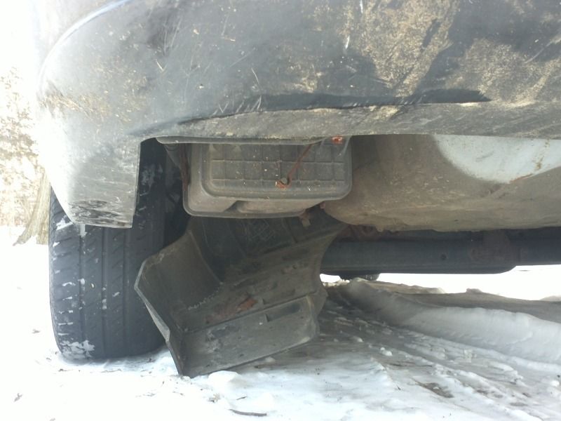

I just noticed some sort of shield or something hanging off the bottom of my 01 Sentra XE, on the back of the passenger side.
I'm not sure what is being shielded there, it's under the trunk on the opposite side of the spare tire well as the muffler/exhause pipe. Looks like a box of some kind, but I didn't get a good look at it before the sun went down. I'll look again in the morning.
I know some shields are relatively safe to just remove and not lose any sleep over, but I'm not sure what this is or if I should remove the rest of it. Right now, it seems to almost be touching my rear passenger tire, which can't be good. Remove it, or have it put back on?

Snapped a picture this morning of it:
http://i57.photobucket.com/albums/g205/mnrgilden/IMG_20130102_084930.jpg
Sorry for the poor quality, it's from my phone and as you can tell, its pretty cold outside!
What do you guys think I'm looking at here? Rip it off or see if I can figure out how to put it back on?
ok, hold on a minute. you said this was on the passenger side. the pic you have is of the driver side.
that piece of plastic is to protect your evap box from excessive dirt and water getting splashed on to it, as theres electornic sensors, and you dont want water in your evap box. but dont worry, all that stuff is on the front side of the evap box, so you should be good. from the looks of it, you are only missing clips on the back section, you can fix this with some clips, or even zipties or something.
see the corner on the ground? there's a small hole where a clip should get pushed in, just lift the plastic to the rusty metal, where there should be another hole for the clip, and push a clip thru both holes. you can use a ziptie or something if you dont have clips. there should be another matching hole on the passenger side of the evap box, it seems you lost both rear clip.
if you need to, you can also drill/punch a hole into the plastic liner, and ziptie it up somewhere. you may be ok without the plastic, but its just as easy to fix it.
EDIT: theres no screw holes on the evap box, so dont drill/screw into the evap box (the grey plastic box), its a pressurized evap system.

Discussion Starter · #7 ·
::facepalm:: Did I really say passenger side? That's embarassing, yes, I meant driver's side.
So that's the EVAP box, eh? That's what has been throwing error codes that keep my engine light on lately. Yikes, this thing isn't supposed to get wet you say, but look at how it is exposed to the snow and ice. Well, passing inspection should be fun this year! ;)
I can dig up some twist ties and get that back up. That will be enough to hold this? I was afraid to use plastic in case it is something that gets very hot. Thanks for your helpful input!

yea, thats your evap box, its basically a charcoal canister, you dont want water inside of it, as if its cracked or something. what codes do you have? you should check your ses light, noone wants to drive retarded.

2,679 Posts
p1491 - vacuum cut bypass valve
p0420 - precat below thresold
im sure a mechanic wouldve quoted you $1500 to rebuild your motor, if you had fixed this earlier, its possible that you couldve fixed this with a catless header (<$100) and some antifoulers (<$20) without having to worry about your headgasket, or other internal failures. and you wouldve passed inspection in most states. you should check out the precat faq in the tech section. hopefully you dont suffer from precat failure like most people do, which you probably will if its been years with that code and you havent remove/replaced the precat. also, these might be emission codes, but as far as your afr is concerned, this means your afr will be really rich, basically, really bad gas mileage.
your vacuum cut bypass valve is in between your fuel tank and the evap box. i would take a look at things, its possible your liner that was hanging couldve banged/yanked/cracked the hose for this valve, or maybe yanked on some wires causing a disconnect.
