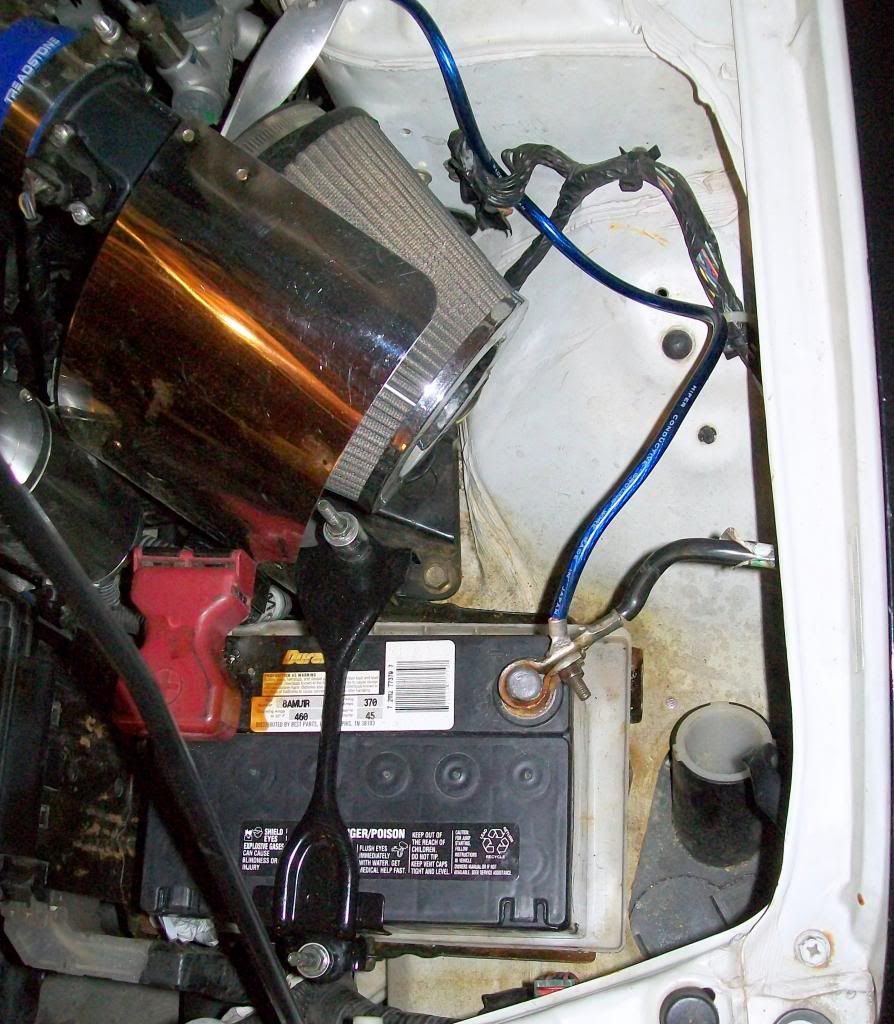

just to be sure i ran two grounds,
from the negative terminal to bare metal on the block and body

Nice pic yogi. Im gonna ground it to the block. I think im losing my charge through the negative terminal. Im also gonna pick up the anti foulers. I have an 02 spec so my primary is on the second bung of the header? Antifouler goes on the bottom bung right? Im going to double up the spacers. If all else fails im going to pay someone to relocate the o2 sensor behind my only cat.
